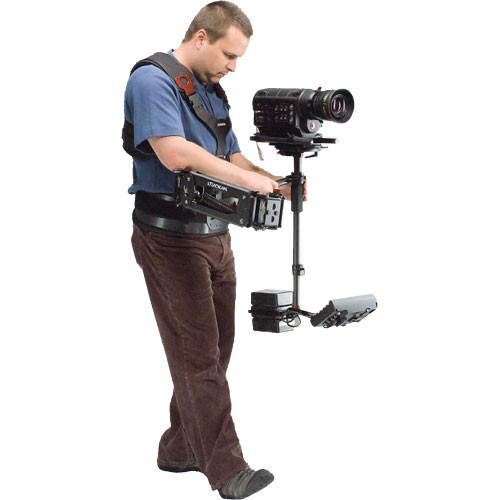

Click here to go to the first RED TEAM post in this thread.   Thread: sync multiple cameras and audio?
Page 1 of 3 123 LastLast
Results 1 to 10 of 25
  1. #1 sync multiple cameras and audio?
    Banned
    May 2008
    262
    is there a good way to sync multiple cameras?also video and audio?
    Senior Member Emery Wells's Avatar
    Feb 2007
    666
    Not sure what you are trying to achieve but generally one would jamsync TC from an external source however I have not have had any success with Jam Syncing in B15 but I must be the only one because Ive never heard anyone else say anything about it.
    A beer for anyone that can show me how they have successfully jam synced in B15.
    Emery Wells @emerywells @KatabaticNY
    Founder/CTO - Katabatic Digital
    KataData iPhone Data Rate Calculator
    http://katabatic.tv
    NYC EPIC Rentals + Scratch DI/Transcoding
    emery [at] katabatic [dot] tv
    Banned
    May 2008
    262
    how accurate is that?(if it work?)
    is there a way to make it frame accurate(make all the cameras sync at the same time(not sync the timeline the actual frames))? and also how accurate would it be to sync the audio(if audio was not recorded with red)
  4. #4
    Apr 2008
    Los Angeles, CA
    118
    I can't show you cause I'm in LA, and not on a red job now, but I have been successfully jammed from the audio guys with b15. I think they synced me off of their digi-nagra?
    amrrahmy, you can just sync the timecode on all cameras by "jamming" te cameras with a timecode generator. A second step which yo may want to onsider is genlock. Not sure if it actually works with these things, but you should be able to genlock the cameras together through the genlock port. Genlock will sync the scan lines on the cameras, so you won't see a scan line jump when you're cutting back and forth between two cameras.
    Anders Yarbrough
    Digital Imaging Technician / Post Consultant
    Member of IATSE 600, SMPTE
    Los Angeles, CA
  5. #5
    Senior Member Emery Wells's Avatar
    Feb 2007
    666
    Quote Originally Posted by ayarbro View Post
    I can't show you cause I'm in LA, and not on a red job now, but I have been successfully jammed from the audio guys with b15. I think they synced me off of their digi-nagra?
    amrrahmy, you can just sync the timecode on all cameras by "jamming" te cameras with a timecode generator. A second step which yo may want to onsider is genlock. Not sure if it actually works with these things, but you should be able to genlock the cameras together through the genlock port. Genlock will sync the scan lines on the cameras, so you won't see a scan line jump when you're cutting back and forth between two cameras.
    Are you *sure* its working? Have you shot a TC slate, pulled a clip into RC and compared the RC TC readout to the slate? Also, have you tried 29.97 or only 23.98?
    Emery Wells @emerywells @KatabaticNY
    Founder/CTO - Katabatic Digital
    KataData iPhone Data Rate Calculator
    http://katabatic.tv
    NYC EPIC Rentals + Scratch DI/Transcoding
    emery [at] katabatic [dot] tv
  6. #6
    Apr 2008
    Los Angeles, CA
    118
    Haven't pulled stills, but have held the slate open to the timecode on the lcd and they match. I have, sometimes, noticed a drift. At which time you just re-jam...just like a slate. The trick I think I'll use on the next job is to just velcro a clock-it box on the side and have it constantly feeding the RED, so that it won't drift any longer. (That way I can get lazy with my slates ;).)
    Anders Yarbrough
    Digital Imaging Technician / Post Consultant
    Member of IATSE 600, SMPTE
    Los Angeles, CA
  7. #7
    Senior Member Emery Wells's Avatar
    Feb 2007
    666
    Quote Originally Posted by ayarbro View Post
    Haven't pulled stills, but have held the slate open to the timecode on the lcd and they match. I have, sometimes, noticed a drift. At which time you just re-jam...just like a slate. The trick I think I'll use on the next job is to just velcro a clock-it box on the side and have it constantly feeding the RED, so that it won't drift any longer. (That way I can get lazy with my slates ;).)
    Thats what we do. This is especially helpful on multicam shoots because you don't have to keep track of every time an AC power cycles the camera. However, we have had no success in B15.
    Have you tried 29.97?
    Emery Wells @emerywells @KatabaticNY
    Founder/CTO - Katabatic Digital
    KataData iPhone Data Rate Calculator
    http://katabatic.tv
    NYC EPIC Rentals + Scratch DI/Transcoding
    emery [at] katabatic [dot] tv
  8. #8
    Senior Member Emery Wells's Avatar
    Feb 2007
    666
    Quote Originally Posted by ayarbro View Post
    Haven't pulled stills, but have held the slate open to the timecode on the lcd and they match. I have, sometimes, noticed a drift. At which time you just re-jam...just like a slate. The trick I think I'll use on the next job is to just velcro a clock-it box on the side and have it constantly feeding the RED, so that it won't drift any longer. (That way I can get lazy with my slates ;).)
    Thats what we do. This is especially helpful on multicam shoots because you don't have to keep track of every time an AC power cycles the camera. However, we have had no success in B15.
    Have you tried 29.97?
    Emery Wells @emerywells @KatabaticNY
    Founder/CTO - Katabatic Digital
    KataData iPhone Data Rate Calculator
    http://katabatic.tv
    NYC EPIC Rentals + Scratch DI/Transcoding
    emery [at] katabatic [dot] tv
  9. #9
    Senior Member Andrew M.'s Avatar
    Jan 2007
    Virginia EPIC #2441
    1,884
    Quote Originally Posted by Emery View Post
    Thats what we do. This is especially helpful on multicam shoots because you don't have to keep track of every time an AC power cycles the camera. However, we have had no success in B15.
    Have you tried 29.97?
    Did you have success with it on other builds?
  10. #10
    Senior Member jimhare's Avatar
    Sep 2007
    Sydney Australia
    3,581
    Can this be done wirelessly? I do multi-cam shoots and run guys all around a live theater.
