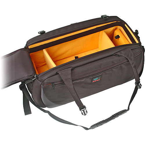

Thread: camera bag
Results 1 to 9 of 9
  1. #1 camera bag
    Senior Member Radim Schreiber's Avatar
    Oct 2008
    Iowa, USA
    257
    What do you use for camera bag? Are there camera bags designed for RED?
    Do you have a way to fit LCD in the bag?
    here are few bags that look like they could work:
    Assuming that camera is all built up, with lens, possibly with matte box.
    http://www.cinebags.com/cameradaddy.html
    http://www.adorama.com/PBCTC1.html
    Thanks
    Radim
    Senior Member Paul Kalbach's Avatar
    Apr 2007
    Oakland, CA
    331
    Several of us use the Tamrac 5258 Cyberpack 8 for airline carry-on work.
    For non-air travel work, I want to check out the Kata CC-197 when I'm at NAB (http://www.kata-bags.com/product.asp...&Version=video). It looks like one could keep a fully-built RED, including mounted mattebox, ready to pull out and shoot.
    Feb 2007
    1,886
    while not cheap, the smuggler from porta brace is a great solution. it has padded bags
    for the view finder and the 18-50
    http://www.portabrace.com/productA-SMG-2
    Paul Hazlett
    Philadelphia Red #1350
    "Cheesesteak" EPIC-X #000257
    "Gertrude" Scarlet-X #000128
    phaz@verizon.net
  4. #4
    Senior Member Paul Kalbach's Avatar
    Apr 2007
    Oakland, CA
    331
    Portabrace also has a new RED-specific case:
    http://www.portabrace.com/productA-DVO-4RED
  5. #5
    Senior Member Frank Martin's Avatar
    Jun 2008
    Miami/NY,NY
    211
    We use the PETROL PDBR-6 as a set run bag and a local travel bag between locations on busy days. It even takes 24" rods for the 24-290 Optimo .Very well made. To travel we use the KATA-HB 207 backpack for air travel.Its a life saver also very well made
    Frank Martin
    Powerhouse Filme
    IATSE 600 DoP
    www.fmartin.com
  6. #6
    Petrol bags are amazing. I can fit everything you need for the camera and the bag itself it's pretty hard on the edges. It's supposed to be water resistant too.
  7. #7
    Junior Member Shamol Majumder's Avatar
    Apr 2007
    Switzerland
    18
    What I know from Kata is that they will introduce a raincover for the RED ONE. That's at least what they told me last october, so in the mean time there's maybe even more to come.
    We'll know tomorrow :)
    I will stick anyway with Kata since I am their biggest fan
  8. #8
    Senior Member david farland's Avatar
    Dec 2006
    Sydney
    1,509
    Kata 3 Banana bag is a nice quick draw bag.
    Has internal of 24x11x11".
    Attachment 11999
    Dave
  9. #9
    Senior Member Radim Schreiber's Avatar
    Oct 2008
    Iowa, USA
    257
    Banana 3 looks pretty sturdy, but it is very expensive.
    I purchased Kata CC-197 for $217: http://www.bhphotovideo.com/c/produc..._HDV_Case.html
    On Kata website say that it would fit RED camera.
    It is little bit longer - 26"
    Side pocket looks little tight, but we'll see what will fit in there.
