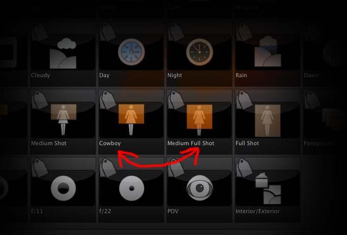

    Tagging
    Tagging is so bloody simple it's a surprise it's never really been done before, at least not in such a simple and intuitive manner that I care to remember. Essentially you have a range of tags (See image) and you drag these tags onto the viewer or timeline, tagging all clips, the whole shot, that individual frame or the whole timeline. Those tags then stay with those shots in the project and are visible in the timeline. You can also create your own tags and there are more features on the way that will advance this functionality in Storm.

    Call me psycho or overly pedantic, but it seems to me that two of the tag icons are flip-flopped. A cowboy shot cuts off just above the knee so the holster with revolver can be captured in the shot... Medium-full is more around the belt line. Or at least that's the way we do it 'round here.
    Thanks Jeff, we'll fix that!
    LOL! As an easterner, I've always wondered a little about a "cowboy". I always figured it as a shot that was wide enough to show head to saddle when he was sitting on a horse. Glad to have that cleared up.
