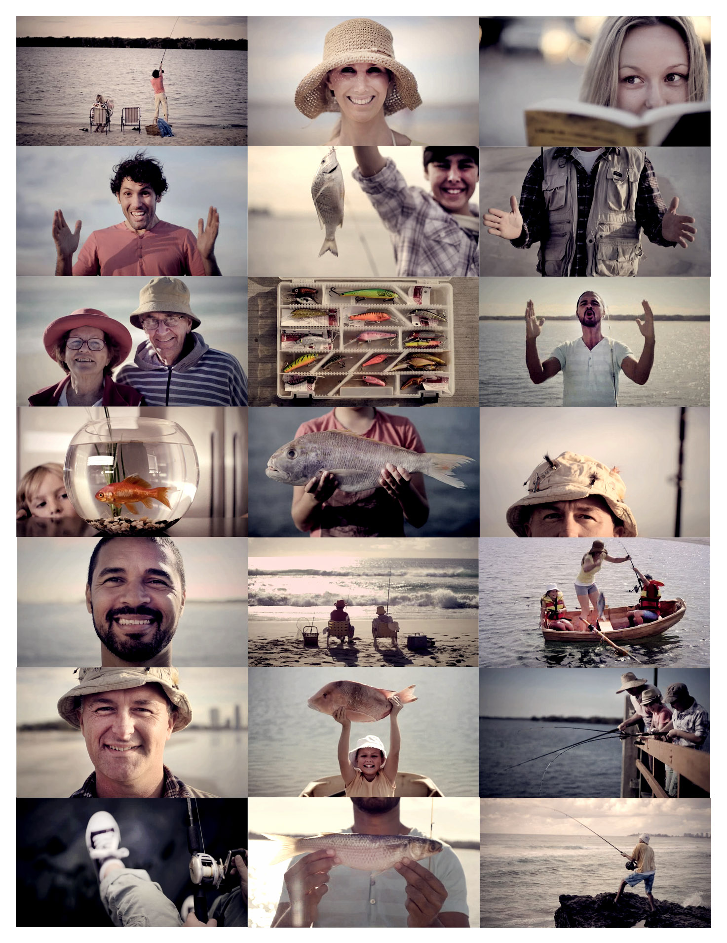

    Hi Justin,
    If you shoot correctly, expose consistently (not saying you don't) and don't keep adjusting your kelvin or tints in camera every shot... (just leave those as neutral as possible)
    Then you shouldn't need to add any look other than what the camera sets for you. Just make sure it looks good in the 5 inche, 7inch PRO (NOT THE EVF) and that will translate out to your transcodes as you see it on the day... well it does for us.
    Or do as I do... output in LOG / or view in log in RCX, set a single frame look that is generic across the board (either in RCX or FCP) Then copy that look across the lot.... and start editing.
    If your exposures are consistent, you wont have to do much in the way of finessing any of the other shots.
    but the secret is consistent exposures, kelvin and tints... Pretend your shooting a 5D for a moment, you have to get your exposures dead perfect with that, or your screwed...
    Do the the same with the RED, then it's as easy as 1,2,3, .. but instead of a 5D, you have about 20,000 looks you can apply afterwards.
    ..... I'll be back.. hang on a min....
    ok.. back..
    ... Just to prove it can be done, I quite literally put a single look on one clip (sorry it was a rush one) and dropped it over the rest, I just took a bunch of screens shots for you.. (i snuck a little window burn in there too :)...
    but over all, only one shot had a grade applied, the others have the same grade copied to them...
    Simple as that.
    hope this helps.
    take care..
    Mark Toia
    www.toia.com
    www.zoomfilmtv.com.au
