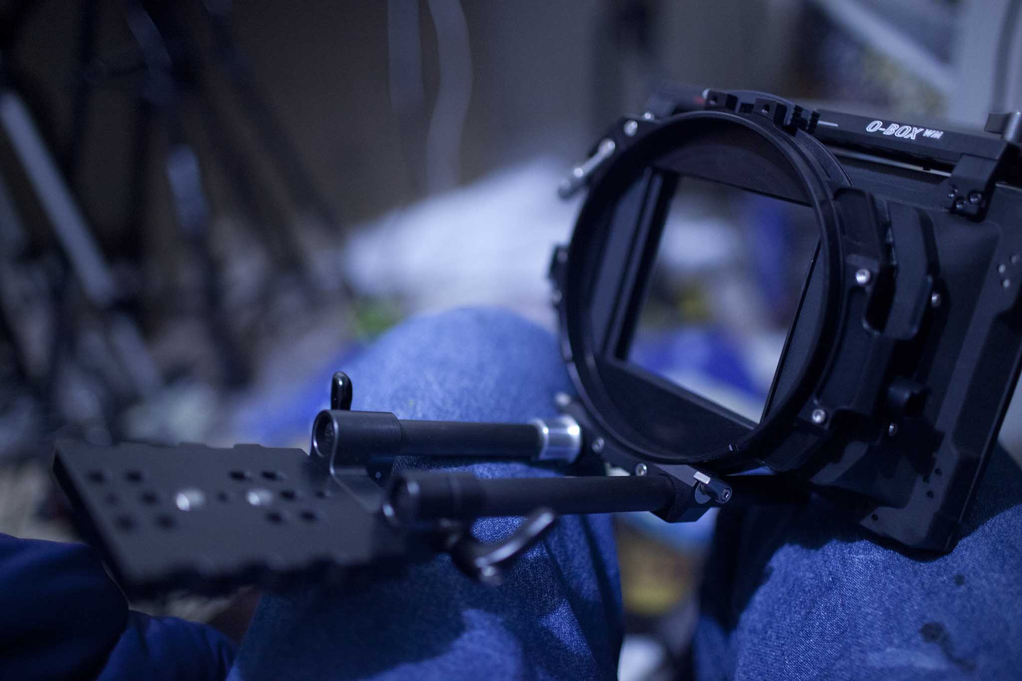

    Senior Member PatrickFaith's Avatar
    Nov 2011
    Northern California
    1,013
    Quote Originally Posted by Ryan Chapman View Post
    Any other suggestions? Especially if anyone has experience with the Trusmt, because that really seems like the best of the lot to me, especially for the price.
    From some other threads, I read about oconner obox and x ... so I bought that ... was fairly inexpensive (considering other options) ... here's the picture:
    http://www.youtube.com/patrickfaithart & http://Pudl.tv
    "Litl" #250 "Pudl" #397 of "Ink" (Monochrome) #3752
