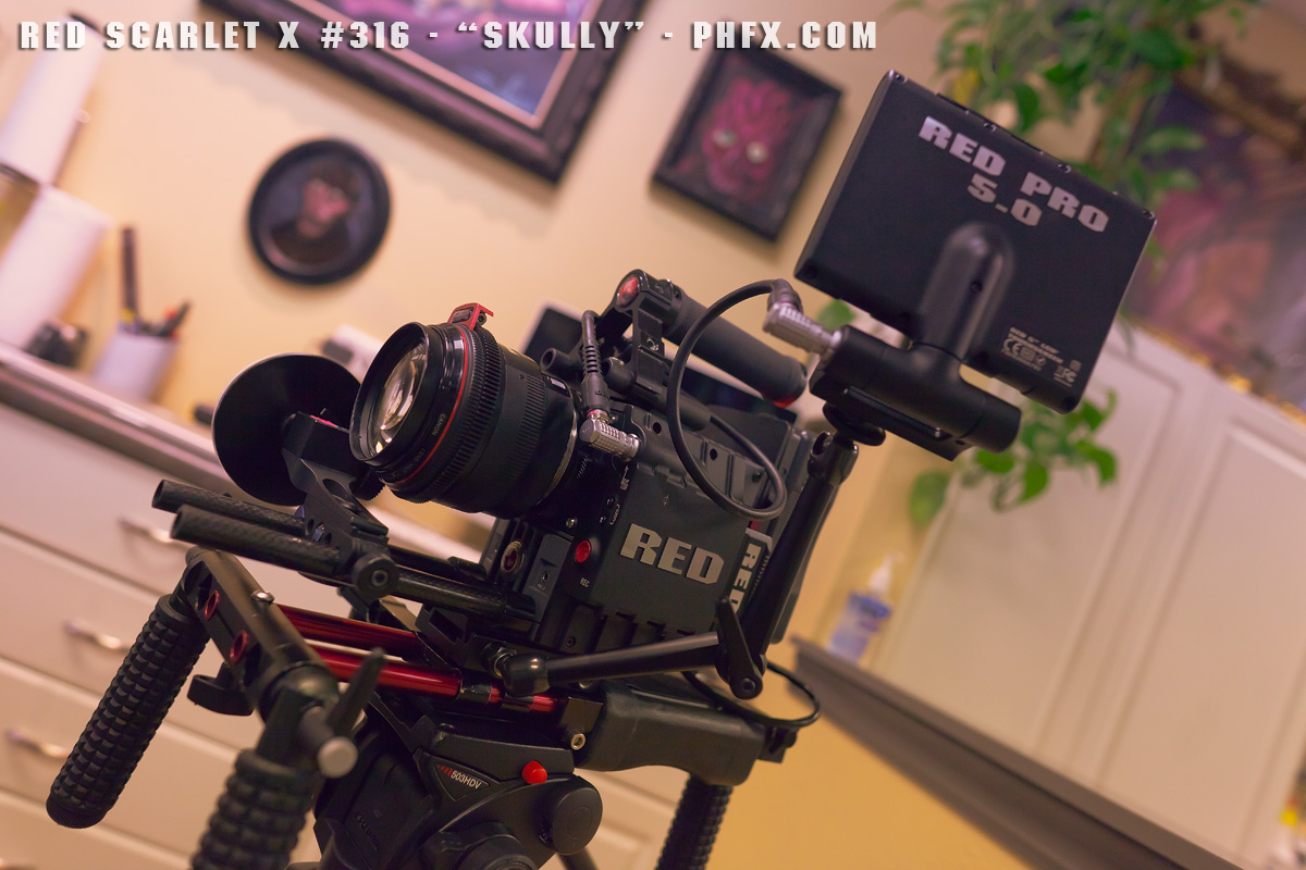

    Phil, A question about how your finding the touch screen & arm config. working for you on the rig as opposed to the fixed position screen option ?
    Judging from the shoulder pad pos. you sitting the camera very close to your head when mounted on your shoulder. I noticed on another thread talk of a longer cable needed between the brain & monitor. Is this because you feel the need to get further distance between yourself & the monitor when operating in this configuration?

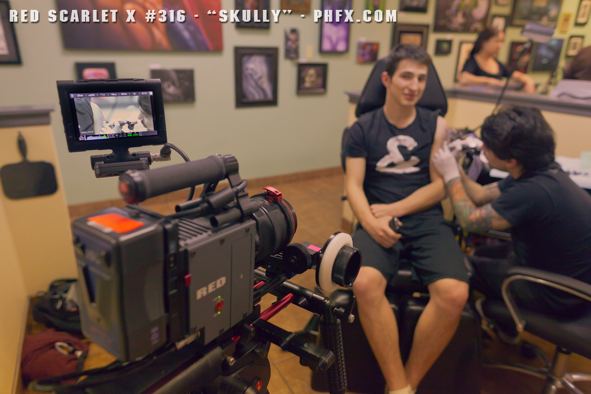

    I'm actually enjoy having Scarlet next to my noggin. The most important thing for me is to actually keep the lens about eye level and my rig is currently doing that. The longer cable allows me to maneuver the 5.0" LCD Touch in more places, especially when not operating on the shoulder. With the stock 7" cable it's pretty darn close to my eyes and doesn't have much slack. Luckily today I got a visit from the "cable fairy" and now have a "war zone tested" used Red 2' LCD cable.
    I had my first shooting experience about 1 hour after I received the cable and you can see how much nicer it is to move the LCD around when on sticks. I would say for my usage the cine/noga/israeli arm is very flexible.
    Here are some pictures from that setup with the longer cable:
    As you can see I can position the 5.0" Touch LCD pretty much where I need it. In this particular case I was operating while hiding in the corner.

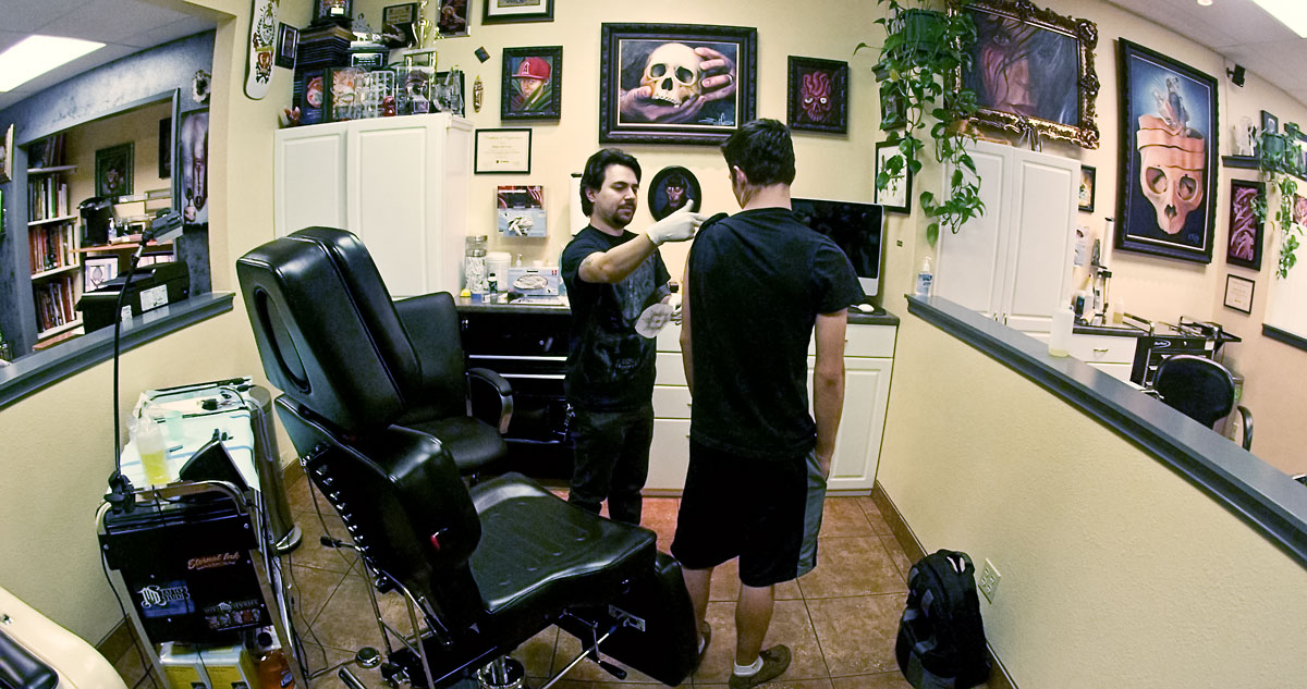

    Today was an interesting day. I have more tattoo content to shoot. This was all under ugly 4800 kelvin fluorescent bulbs. The next tattoo artist I'll be able to light, which will be nice. This was mostly to get idea about the space and what glass I'd like to use.

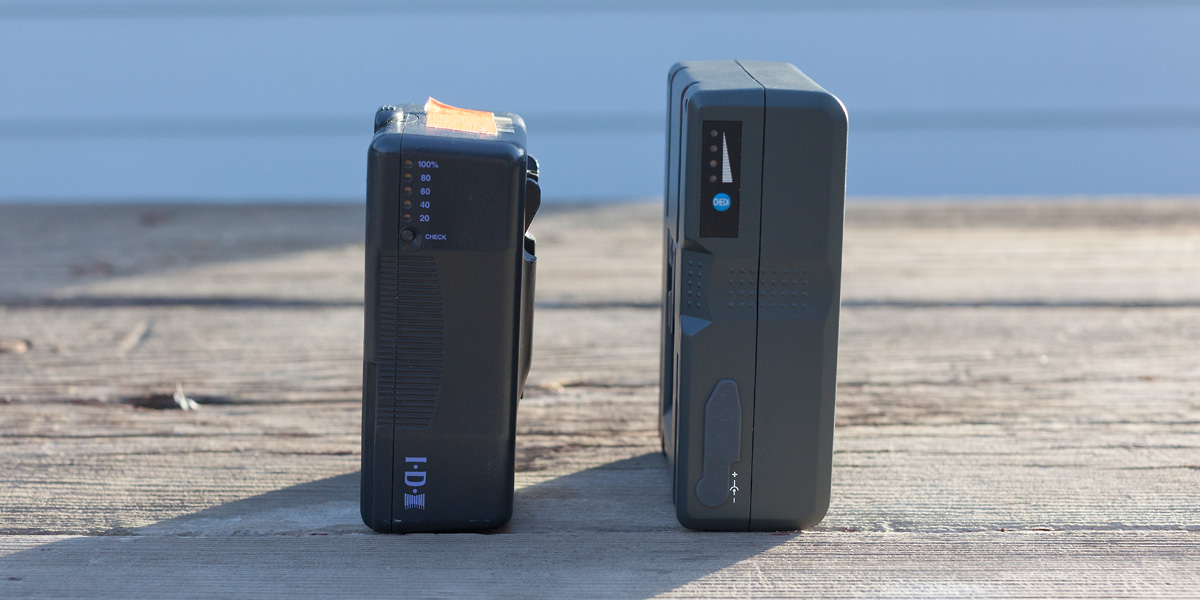

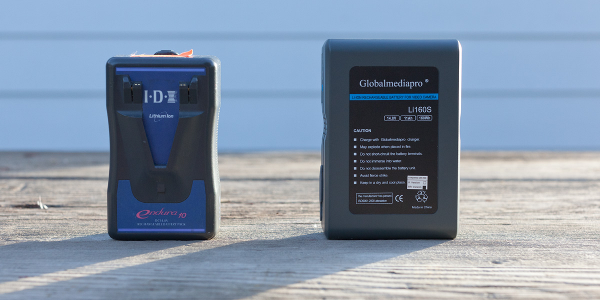

    Once I was home today I had a package from Globalmediapro with 2x 160Wh V-Mount Batteries and their Dual Charger. This should give me around 2 hours and 45 minutes of operation time per charge. If they work out I'll be purchase another two. I'll be testing them tomorrow extensively. IDX I trust, but GMP is new to me. Here's a shot showing the size difference of the IDX Endura 10 (98Wh) I've been using since receiving the Scarlet compared to the GMP 160Wh:
    A bit taller and a bit wider, but not much heavier at all. Upon first inspection, build quality is decent. On this side profile shot you'll see the D-Tap port on the GMP 160Wh as well as where you can plug in their travel charger.
