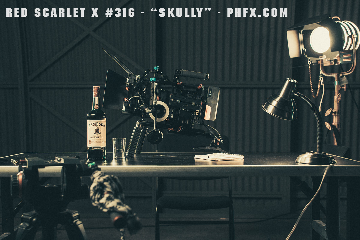

    Will, My rig has gone through a few transformations. My first LWS 15mm setup was a simple 15mm clamp bolted onto a drilled out Manfrotto baseplate. If you are looking for compact, that's about as compact as you can physically get. Then my machinist came through and created a baseplate that's very similar to the Viewfactor plate, with just a couple of simple modifications. My top plate never was actually built sadly. I needed to rig up an additional camera for a two camera shoot not long ago and I ended up purchasing a Gini cage with LWS 15mm, 19mm rods, and the ability to use a bolt on dovetail plate. This now lives on my Scarlet and I have the other components for situations when we need more than one camera.
    Here's what it commonly looks like these days:
    Gotta admit. I change things out depending on the shoot. If I fly the camera on a steadicam or even on a jib I'll swap out to that first 15mm LWS plate.
    Based on my experiences I will rig my cameras with LWS 15mm and 19mm with a dovetail from here on out. Whether it's Red gear, WC, or "other".
    In terms of rod length I'm primarily on 9" carbon fiber 15mm. Works as wide as 11mm and allows up to 300mm comfortably with lens support. I usually have my OConnor O-Box WM on my rig and 9" works for damn near every situation. Here's a side profile image:
    The key thing for me is modularity, which the Red Scarlet and Epic excel at. I've probably configured the camera a couple dozen ways with very little setup time. And the fact that you can get it down in size to do silly things like this:
    Is utterly fantastic.

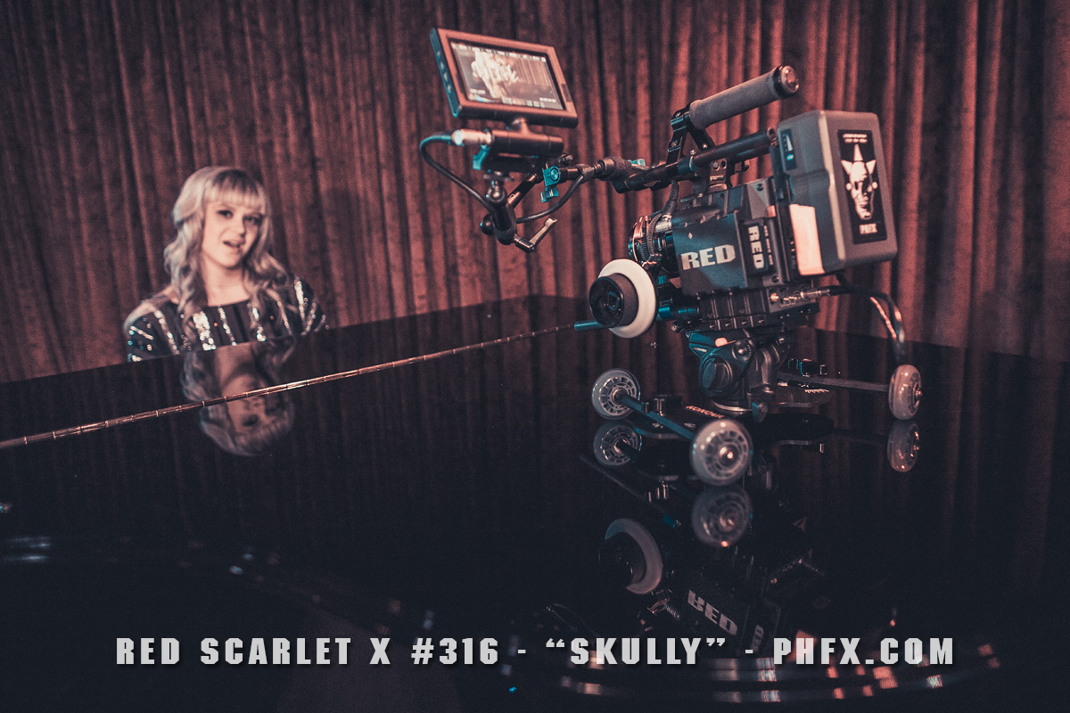

    Firstly thanks for all the info re Scarlet, secondly I see you have a small dolly on the piano, who manufactures those, l have a smaller version made by Peco but is too small for the Scarlet.

    I randomly was at FilmTools (in Burbank) the day before this shoot and I saw this cute Konova tabletop dolly sitting all alone in the back. It was like $150, but I started imagining using it on the piano surface, so I grabbed it. I have used it one other time since then. It's not the best tabletop dolly I've used, but it's the least expensive by far and supports the weight of the Red Scarlet just fine. It came with a swanky little orange and black zip up carrying case which protects the wheels.
