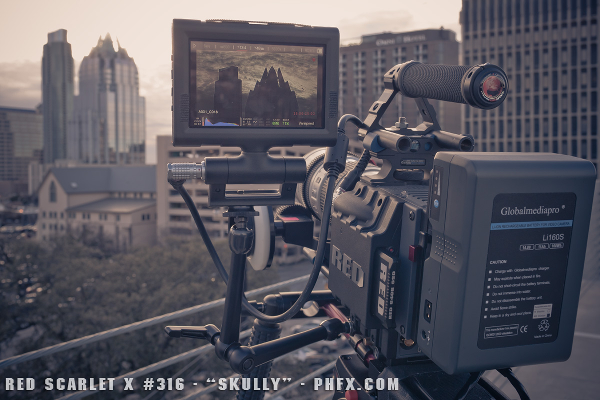

    Some quick info on those curious. I just got back from a solid week shooting in the field with just two GMP 160Wh (Red Version) batteries.
    On the Red Scarlet X shooting at pretty much 4k the entire time I'm getting around 3 hours of operation. They also take around 3 hours to charge. Likely a bit over that. The "Red" version of these batteries do indeed communicate the capacity percentage back to the camera as long as you have an Switronix or compatible V-Mount plate connected to your camera.
    If you look closely you can see the capacity percentage readout here:
    Incredibly useful.
    Only downside so far on these batteries is that damn rubber D-Tap cover pops off too easily. That's more my fault I guess than the battery.
