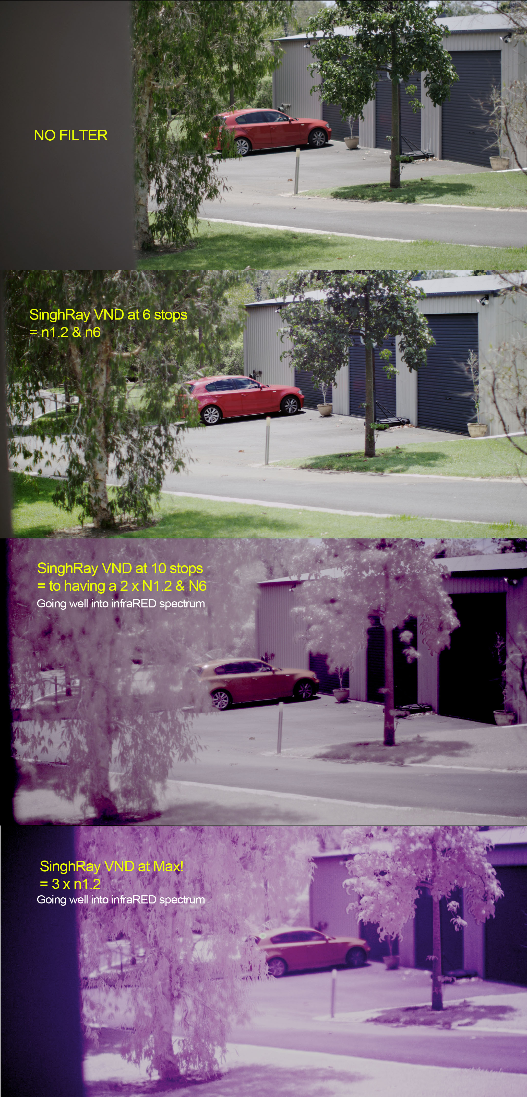

    Test two was purely optical. LENSE testing, Variable ND testing. Just quickly, I HATE VND's, but we tested them anyway.... and I thing for the very first time I maybe a convert. But only brand stood out : The Singh Ray, Bloody expensive for what it is... but a stand out winner.

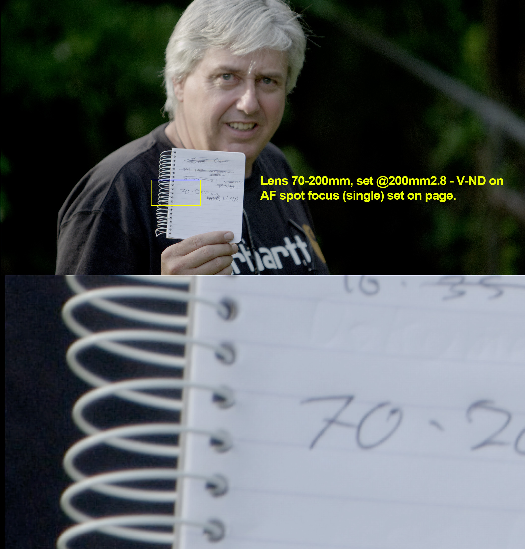

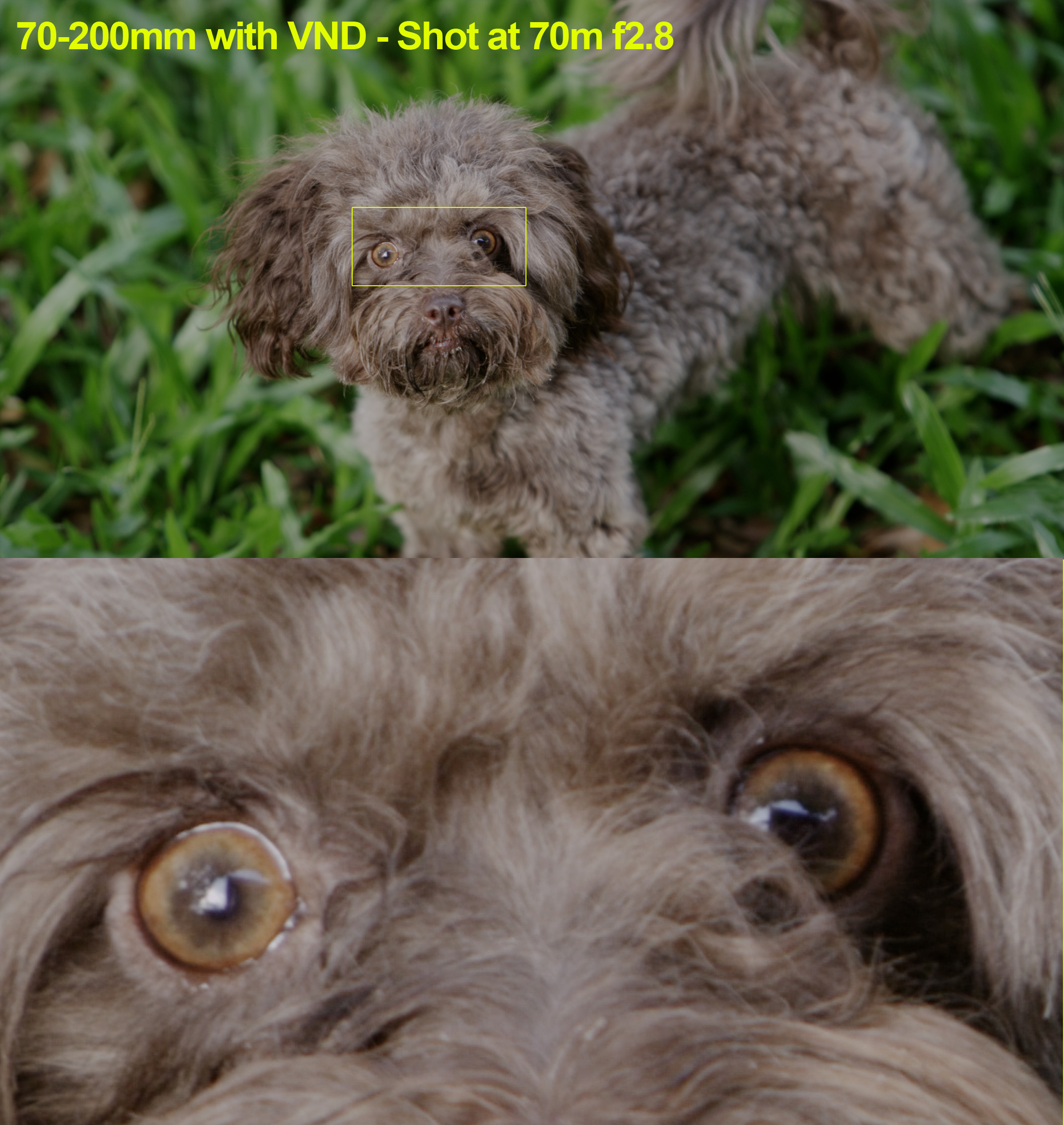

    The 70 - 200 F2.8 was the over all winner for ZOOMs. It just did everything good. Sharp everywhere, AF system work well (considering its a ZOOM with lots of glass to spin around)
    Sharpness, Easy 9 out of 10 even with Variable ND's on.
    The lens stabilisation function is what go me... Un believable. !

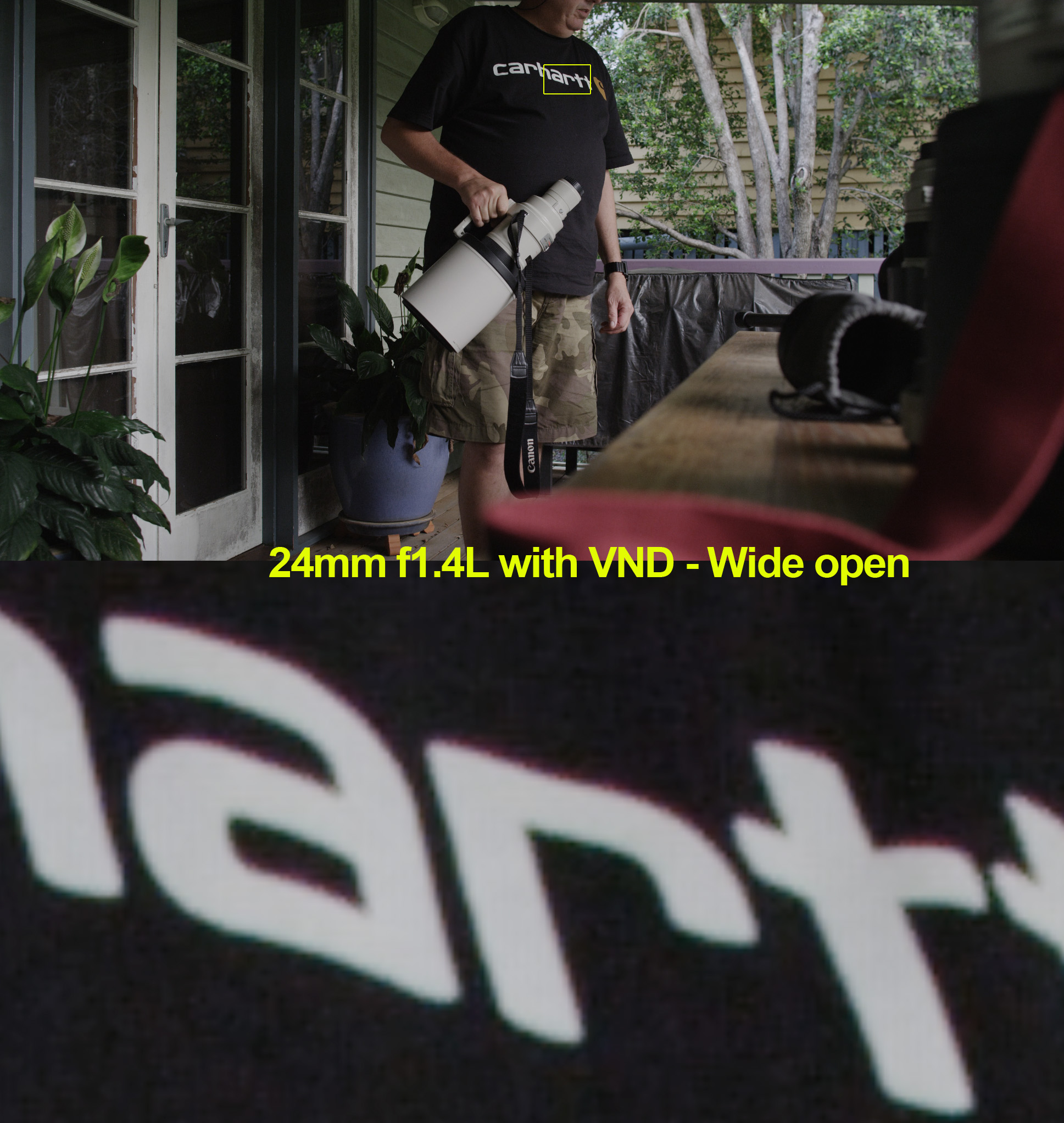

    The 24mm 1.4l is pretty much one of my most favourite wides. Im not big on lenses under this as I've never been a fan of wides or lens distortion.
    This lens how ever never looked that sharp on my 5D (retired) but for some reason, even at f1.4 its sharp as!
    Way sharper than the Ziess Super speed, sharper than Arri ultra prim and a master prime, plus you get lens capable of 7K image area meaning no dark corners like you get on the lens I just spoke of.
    [COLOR=#FFFFFF !important]Lets get this straight.. Regarding ND's
    I get this same look when I stack to many ND's in front of the lens.
    So lets be fair to the little VND.

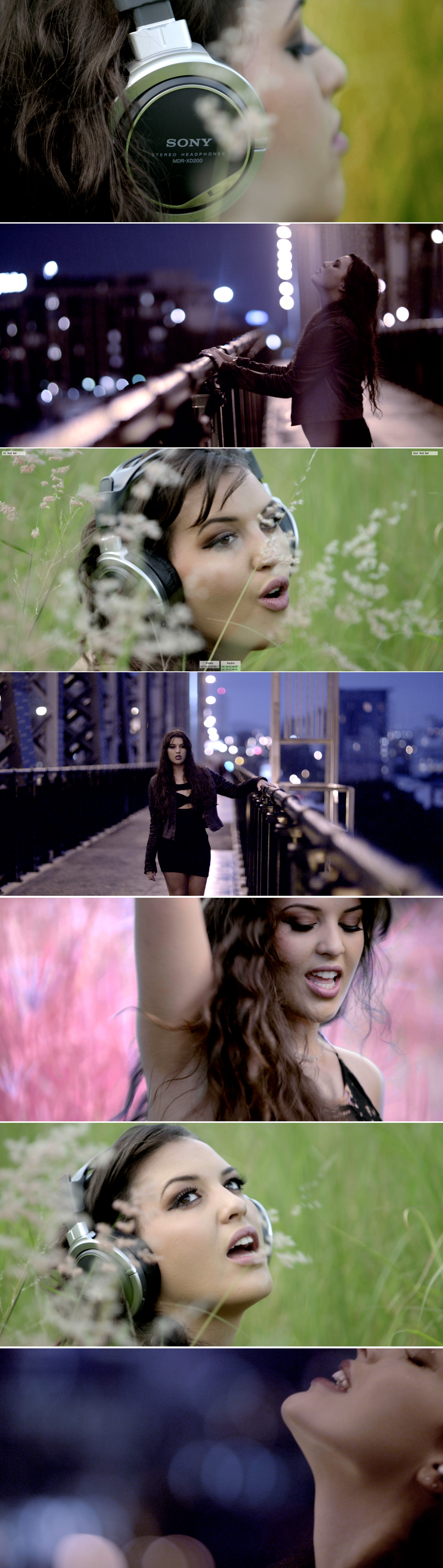

    [COLOR=#FFFFFF !important]I just finished shooting another quicky music clip for my daughter... (yes another one!)
    Decided to use the CANON glass for it all... Its my first project ever using stills glass on RED, I just wanted to see all the things that would catch me out, trip me or stuff me up.
    Better to do it on a personal project, not a paid one I say.
    REPORT CARD:
    *Shit to manually focus. (but we all new that)
    *Amazingly clean edges... no vignetting.
    *Sharp as... but smooth, very smooth... better than I hoped for.
    *Great at night, smooth and creamy, little to no specular bounce, meaning good coatings.
    *Low flare threshold but when there is a lens flare, its not a pretty one.
    *AUTO focus on the EPIC is quick to prefocus when not recording... I really like it. No need to ZOOM in for a look, it just snaps to sharps with little hunting. Low light AF is a slower. When you roll and want to focus its abut 1/4 speed. (I'm sure this because the chip is processing information and trying to focus at the same time)
    *After a bit of getting use to, I think I became faster in setting focus with canon glass than my PL glass.. Sad! Only because there are focus aids and Im really starting the trust the AF on the EPIC as being dead on.... so far.
    * Setting Aperture is a bore. The toggle just in front of the record button on the side grip is the logical place to have a aperture adjuster. The up and down buttons are just too slow and awkward. I'm quicker at setting the aperture with the touch screen or through the thumb controls on the side handle as if you were changing anything other settings across the top menu bar.
    Over all rating. is 7 out of 10 from me. (which could slip out to a 8.5 out of ten if the AF gets quicker and the Aperture gets quicker to adjust and the aperture dial gets reassigned to a better place.
    Put it this way, My ZIESS MKIII's I only give a 6 out of 10,
    To be honest... I doubt I'd use these lenses much in the world I work in, Big crews, with big gear, big shots, cranes, stabilised heads, Mo Con etc... forget it, Canon stills just dont live in this world....
    But for simple arty jobs, were you want to travel around the world with a back pack shooting art, Yes please....
    Here's a couple of stills from the shoot.

    Looks nice Mark! I'm guessing your "100%" on all of those images is a typo?

    oops.. Refresh :)

    The Canon 70-200mm 2.8 is my favorite all around lens... , so it was the first one and longest one we worked on, glad you like it.
    the new build coming in the next couple days will have a lot more lenses supported, like the Zeiss MF etc, and a new revision of the AF algorithm that performs a lot better across all lenses.
