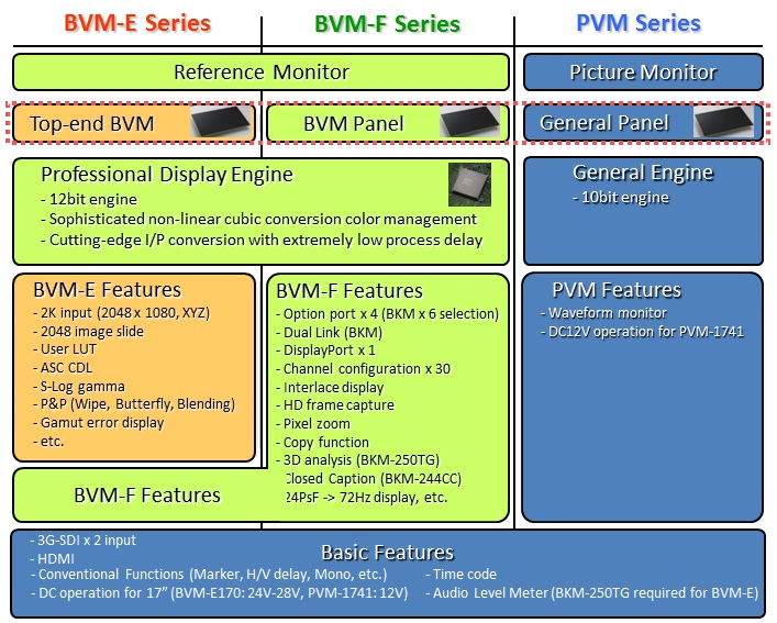

    I'm curious if there will be price cuts for the Sony BVM-Es at NAB. After all, they introduced the BVM-F series because the Es weren't selling too well, right?
    Is there any difference to the BVM-E/F panels in reality or is this marketing piece just a bunch of BS?
