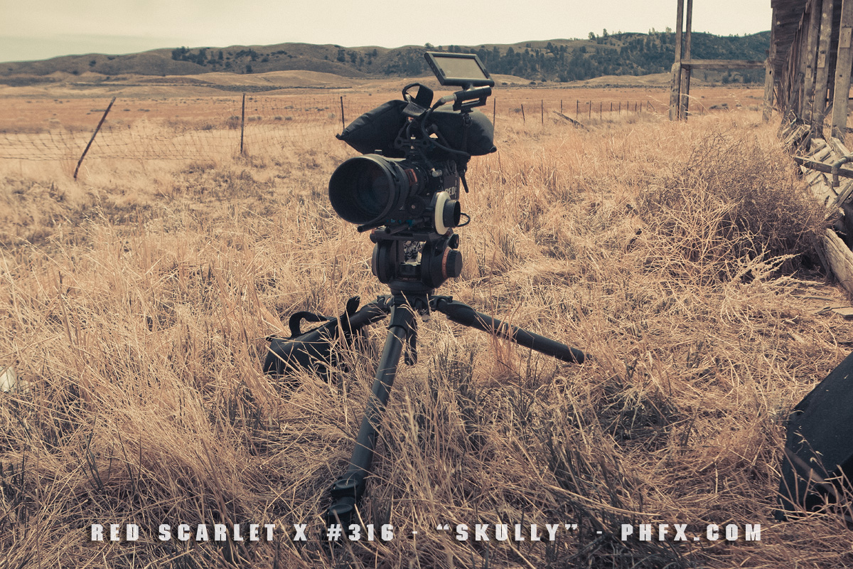

    Camera: Red Scarlet X #316, "Skully"
    Format: 4k, 23.98, RedCode 6:1, 1/60th, ISO 320-3200
    Runtime: 3:59:12 - 5,748 frames
    Lenses Used:
    Canon EF L Series Primes:
    24mm f/1.4L, 35mm f/1.4L, 50mm f/1.2L, 85mm f/1.2L, 135mm f/2L
    Canon EF Primes:
    20mm f/2.8, 100mm Macro
    Canon EF L Series Zooms:
    24-70mm f/2.8L, 70-200mm f/2.8L IS
    Leica R:
    60mm f/2.8 Elmarit-R
    Sigma EF:
    14mm f/2.8, 300mm f/2.8

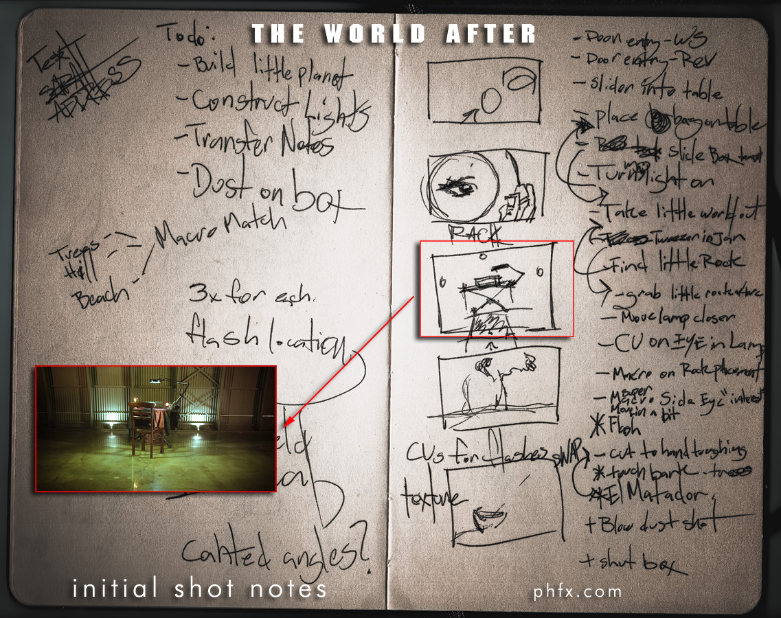

    I spent a day doodling, writing down ideas, buying some wardrobe, and building props. Started with a brisk brainstorming session which led to about 20 ideas. Then I went through a review process eliminating the impossible and not so good paths and found something interesting. After deciding which direction to go I started fleshing out the idea. Mathematically speaking, knowing the short couldn't be longer than 4 minutes; I made a delibrate decision about working with a 6, 3, and 1.5 second cut mindset based around a 160bpm music track (that would need to be scored later). I figured that I had about 50-70 cuts to get my idea across with approximate shot "bleed". That's not a lot of time to tell a deep story, but you can get a lot done. I kept this in mind as I started storyboarding and jotting down my notes.

    Fleshing Out the Concept
    Knowing that this was to be shown at 4k to showcase Red cameras and post production workflow I decided on a few things early. The first thing was that I wanted to shoot at locations showcasing a lot of detail and hopefully incorporate that detail mindset into the props and wardrobe. Second, part of the challenge here was showing the viability of the 4k workflow. I've been working with Red material using Adobe Production Premium for a long time now and that personally wasn't the big challenge here. However, I wanted to up the stakes (go big or go home) and I made the decision to somehow incorporate what isn't so common in such a small deadline; 3D and 2D 4k VFX work. Third, I wanted to show the flexibility of the Scarlet X by shooting in both low light and high contrast/bright setups, hopefully to disprove some of the myths about what Red cameras can and can't do. Lastly, I wanted to see if I could pull this off by myself. Not for egotistical purposes, but rather to see if I could pull this off within the deadline and to see exactly how much work I could get done in a week. I am one of those nuts that likes the pressure of deadlines.

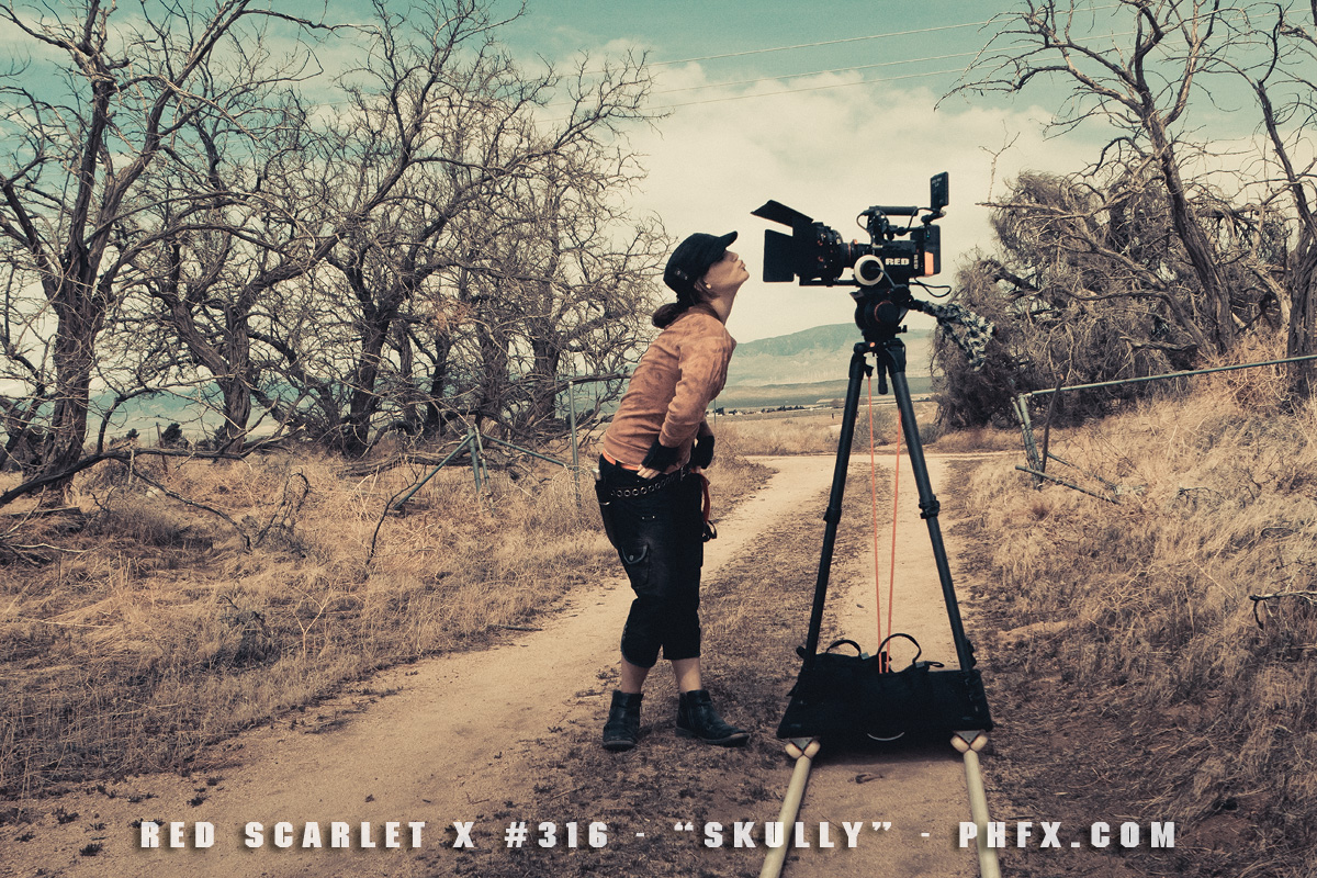

    One thing that bit me hard on the first day of shooting was the cold air and wind. While it did look nice to have the dead trees come alive with movement, it did effect my shots and shooting speed. The first shot of the day and the first shot in the short was low and at 300mm, and I knew then the wind would be an issue all day. I attempted to bag and flag the wind as much as possible, but because I was shooting this by myself with the amount of setups and lens changes ahead of me I just simply didn't have time to do this for every setup. That wiggle at the peak of the establishing shot with the jib looking at the farm in particular could have been stabilized, but I had bigger fish to deal with in post. Sadly the wind blew down the garage where I was going to have the pebble pick up insert shot, but I used it for the background of that sequence instead.
    After a marathon first day everything else went rather smoothly. On the hanger day I came in two hours early and did my pre-light and built my little set. Talent arrived and we got to work. The last day was more about getting fairly precise shots and darting to the ocean to grab the giant boulder insert. Lot's of driving that day. For the slider moves I used my trusty Kessler Cineslider with the 500 motor. This allowed for the sliding move, pan/tilt move, and focus pull to be operated by one guy. However, on the first shots I did actually use a small dolly I built years ago for another production. I used PVC pipe and flattened the dirt under the track. Had to toss in a little DIY problem solving in there.

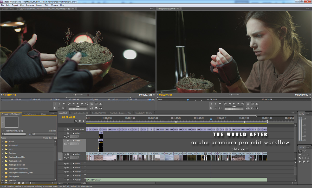

    I did my own data wrangling and kept things very organized. I imported my .R3Ds straight into Adobe Premiere Pro CS5.5 and made the selects extremely quickly. After that I created some dummy 12, 6, 3, and 1.5 second markers to assist with my edit and began cutting. I needed to keep that time base for the music scoring process later. The real challenge was editing and telling the entire story within 4 minutes at a pace I desired. Only 4 shots didn't make the final cut.
    Color Workflow

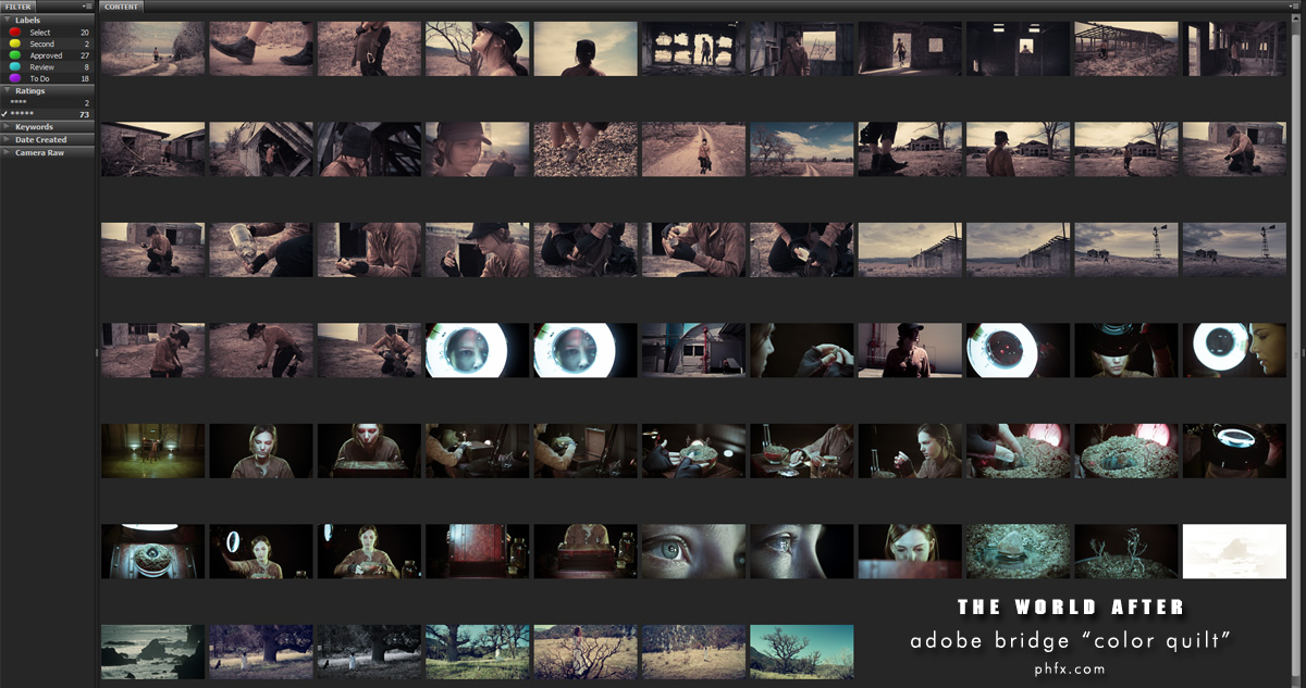

    I wanted to have fun with the color correction and grading process. I was a digital colorist on features for a few years and one of the reasons I chose to buy a Red was just how flexible RedCode Raw is. My first light color correction was performed in RedCine-X Pro. However, I decided on a slightly unorthodox grading workflow by using Adobe Camera Raw. I really wanted to flex the Adobe Production Premium muscle for some reason. This workflow required taking my clips and transcoding them to 16bit TIFs and then exporting the graded files into DPX sequences to re-link back in Premiere Pro.
    I exported key frames from each shot and began my grading process. One of the techniques/tools that I learned back when I was a full-time colorist was to create a "color quilt". All that is a single image with frames of an entire sequence or sequences with thumbnails representing each shot. This gives you a visual index to see if everything is being pulled together and matching up nicely. Back in the day and this was something software needed to be written for as we were on Linux boxes using proprietary grading software at the time, but with Adobe Bridge color quilting is actually a very simple process. I have a customized an Adobe Bridge workspace called "quilt mode" so I can quickly review frames for such an occasion. Very quick and easy to make selects, group, and edit what you're looking at. I would have killed for this a few years back.
    I had a great time grading. I pushed the post apocalyptic world the hardest via a tonal curve with the midtones and darks lifted a fair amount. I kept the lights to highlight roll off smooth. On top of that I smacked the red, green, and blue hues around. Then went in and pushed saturation around a bit. That was a good torture test. This is precisely the type of grade you can't do with other compressed codecs out there. The hanger interiors were more subtle, but I did enhance the sort of sterile light coming from the lamp as that was a point of interest. I did knock the red down a bit. The tonal curve a very slight S to it minus bringing the blacks down. I attempted to have similar hues hitting existing in both the miniature world and the fantasy world. Not too over the top, but hopefully enough to get the concept across. Lastly I went in and added some vignettes and graduated exposure adjustments to shots to help put the focus on specific areas of the frame and guide the viewers attention.
    I don't own a Red Rocket, but my cut was under 4 minutes and I trimmed my clips to have handles of 12-24 frames depending on if they had transitions or not. This also gave me a small amount of wiggle room in case I wanted to fine tune the edit. During this transcoding and exporting stage it gave the opportunity for a couple hours of sleep.

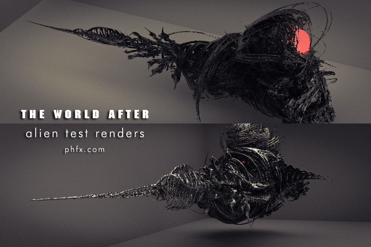

    The Alien
    I wanted this alien being to fly around overhead. To just sort of exist and have it be something she was used to. She would glance up at it here and there, but I wanted it to feel like normal everyday life. We don't know if this thing caused the apocalyptic world or perhaps it is some sort of guardian. I wanted that open ended for the viewer. Some think it's scary, some think it's cool. I like that room for interpretation. I've been creating similar creatures for the artwork of my next music album, however I have never thought of bringing them into motion. Plus I needed to design new ones for this project that would actually work. I've been rendering those out at 5k to print HUGE, but they sometimes take up to 12 days for a single frame. The visual effects take up a total of 1072 frames, nearly 20% of the whole short. I needed many frames as these aren't exactly short shots and I had about 48 hours at this point. I needed to optimize a few things and change a lot of other things. I would call this experimental at best and started tackling some geometry and lighting concepts.

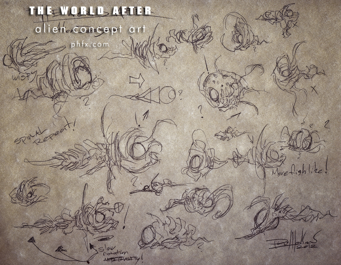

    After wrapping on the first day of shooting I raced home and began on the concept art for the aliens. It's not my prettiest work, but I needed to get some ideas down on paper to start developing a look and visual feel.
    I had a few ideas in there I liked. You can clearly see my excitement in my notes when certain ideas clicked and felt right. After wrapping on the second day of shooting I began to model and perform some look development. I wanted their skin to feel like a liquid trash bag.
    Things were coming together and after wrapping shooting on the third day I began some quick animation and render tests. I wanted them to almost have a gliding/anti-gravity feeling to them. Mysterious and not too threatening. I moved onto a final lighting test using the same high dynamic range image based lighting techniques that I've used on major motion pictures. Which led to:
    You'll notice I changed the red orb to more of an orange. This represents their life force and energy. If you pay attention during the wide shot with the windmill as the orb retracts into the body of the creature the shot itself seems become darker. Hopefully eluding to some potentially more weirdness that's left unexplained. I rendered out my animations at the end of the third day of shooting, which is also why I shot at the farm on the first day. By time I was ready to sit down and edit I had my 4k 3D animations ready to go.

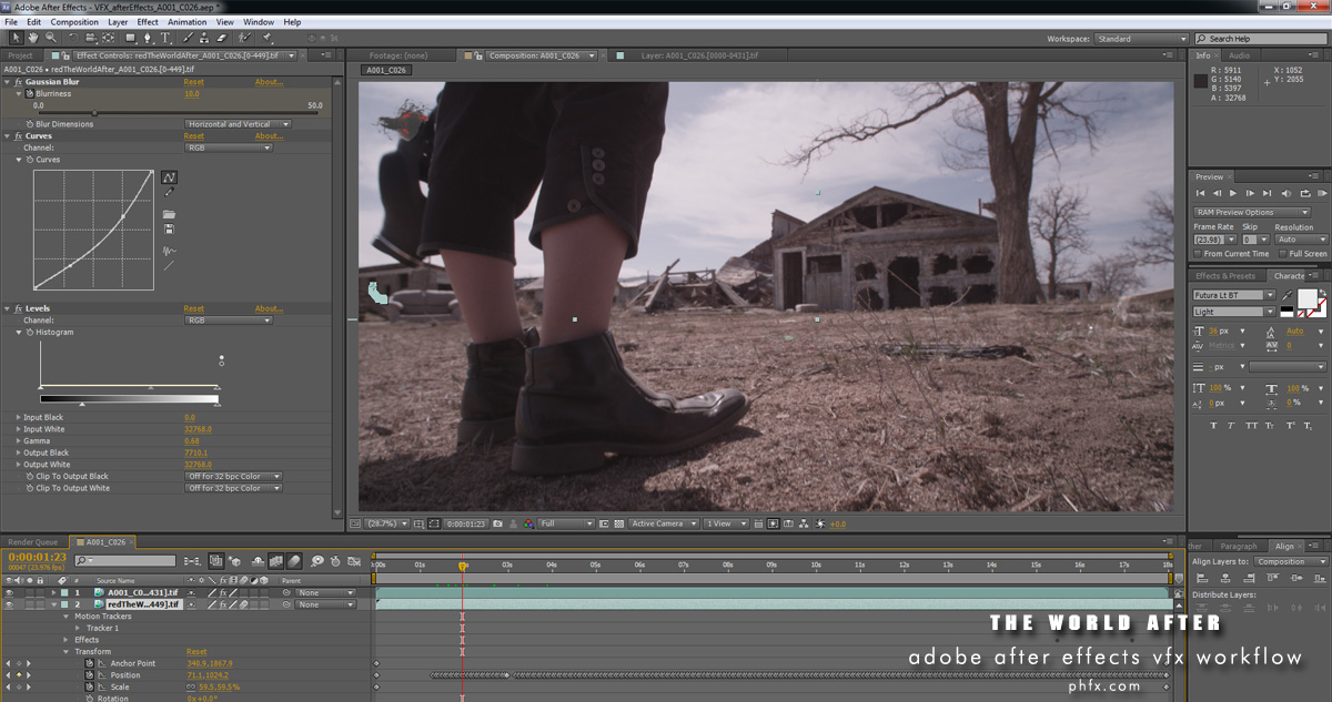

    Awaking from my slumber after the color work had been transcoded I had to get cracking on the visual effects shots and integrate my creatures into them. That meant it's time to open up Adobe After Effects CS5.5 to get down and dirty with motion tracking, keying, compositing, matching focal blur, matching motion blur, adjusting levels, color correcting, and exporting. Not the quickest stuff to do at 4k on long shots. The keys themselves showcase yet again the advantage of having a a lot of dynamic range and shooting with a "fat negative" mindset. There was no green screen shoot here and these were wild extractions within the plates themselves. However, because there's so much information there, even when the alien needs to be behind her shirt (which gets very close to the tonal value of the sky) I was still able to pull off a seamless composite without rotoscoping individual frames. I did a few animated effects like the rack focus on the 14mm wide establishing farm shot to the alien to match the lens pull. I had to smooth out the tracking on that shot as
    parallax made some of the initial track not make any sense at all. That was a combination of a lack of consistent geometry within the frame to grab during the jib move and the distance of where exactly where I wanted place the alien in the sky.
