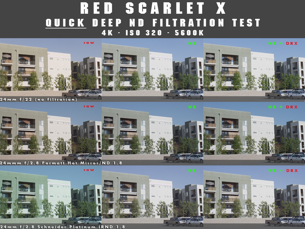

    Apr 2007
    2,391
    Here you go. This is the 1.8 77mm. They have a bit of a cast, but it's not that much.
    I no longer have a 1.5 to do a quick test for you as my entire set of 4x5.65s were stolen last week. Which feels wonderful.

    Sorry to hear about your filters :( Those are exactly the stills I remembered. Definitely less that what I'm experiencing. Strange. Thanks again!
