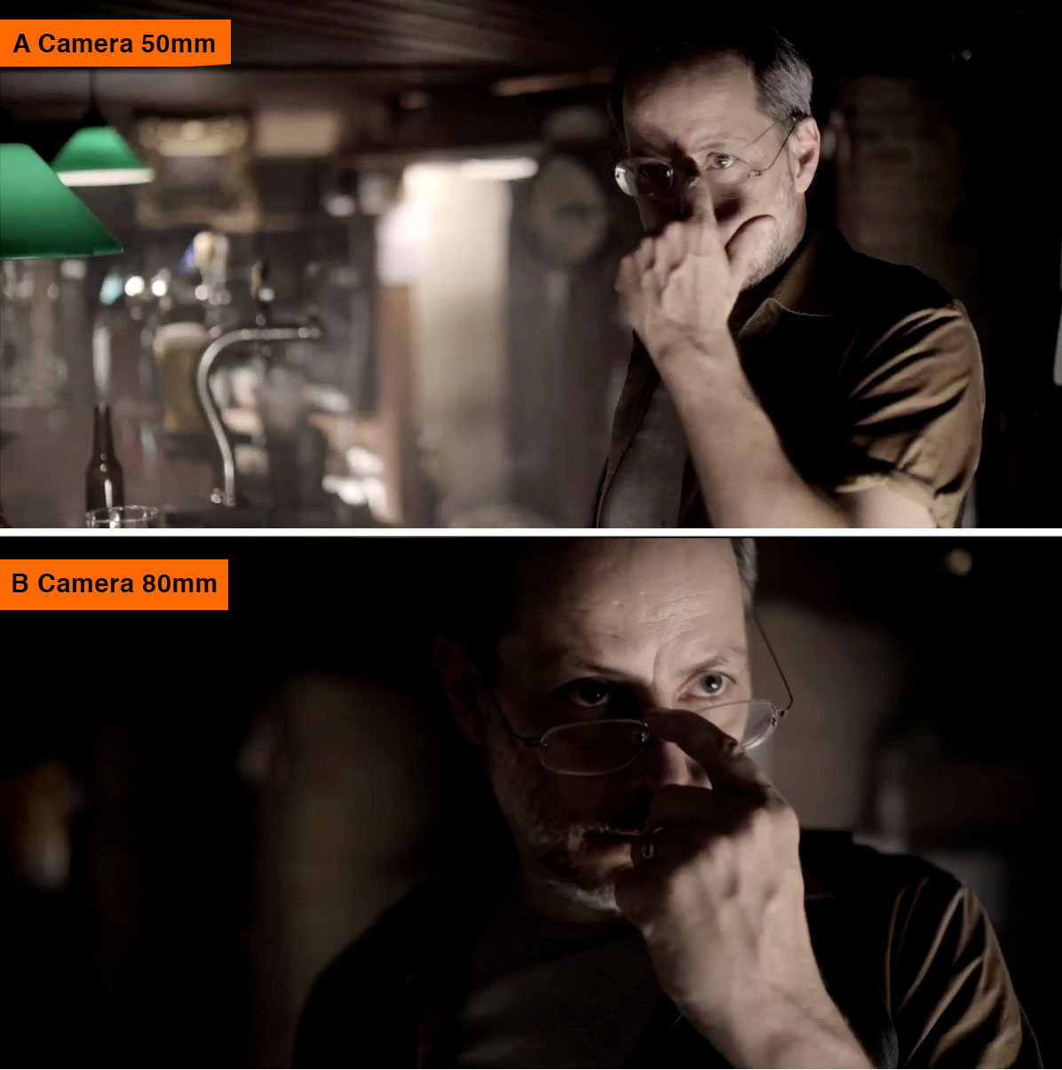

    Oh my... You miss guided soul... I do feel so sorry for you. Not knowing how to make RED images look like Alexa images... It's so easy.
    Send me an ALEXA shot, And I'll match it perfectly.. send me a SONY F65 shot and Ill match it perfectly...
    I've shot so many TVC's with mixed camera footage coming in these days, from Alexa, Phantom, Canons, Epics, ... and we grade them all up the same. I can pull RED back to any of these other formats...
    I cannot believe that you have written this to be honest... ? I've never ever seen this super amazing ALEXA footage that people keep telling me about. I have a lot of it here now stored away in hard drives and it does not look any better than anything else. ?
    paused...
    ok, Im back...
    I'm looking at a string of ALEXA footage right this second, just dragged it up in Premier and I have quite literally dropped a 5k EPIC file next to it... Same shoot, different cameras, different lens.... I'm now spending 30 seconds on grading it to match the Alexa footage. Done.. Perfect. now they are the same. Not very hard... I had to blur the RED footage 1 pixel... as the Alexa footage is no were as sharp... but over all... the tones are identical.
    Colour temp a bit warm in the Alexa footage to start with... But hey, it's a colour baked Pro res.. what do you expect. , but still looks fine.
    Now I couldn't get the Alexa footage to look as sharp or as clean as the EPIC footage, reason why is because EPIC shoots images 4 to 5x the size of Alexa standard output.
    NOW!... If your not grading your footage at all... and just transcoding and using as is, or just using the ALEXA footage as is... not grading that either... Then Alexa has a nicer standard colour lut... But when you get into a grading situation, The EPIC runs rings around PRORES Alexa footage for colour and gamma range... Fact. Why... because one is 10 or 12 bit Prores at MAX res HD... and the other is 16bit, 12 milllon pixels RAW.... So of course to be fair to the Alexa you will have to degrade the RED RAW files to get them down to Alexa spec and look... But once again, so so simple to do.
    It's so so easy to drag EPIC footage back to ALEXA spec... Almost impossible for Alexa to look like RED EPIC footage.

    I'm all with you Mark, but is Epic #2.... ?
    Hard to tell through the jpegs and all, but that'd be my guess...
