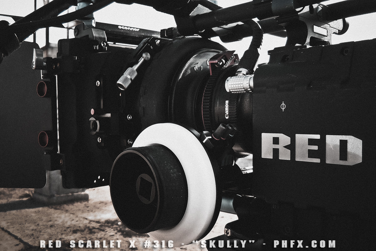

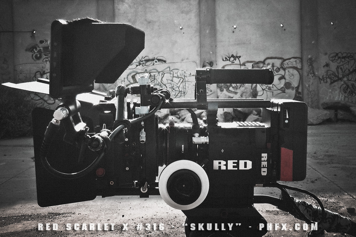

    Cheers Kirk. Glad you enjoyed the Gnomon video! Here's some quick info.
    This is my rig about 90% of the time. However, it's going to change very soon as I've been "gifted" a new cage to evaluate.
    Main components are from left to right:
    -OConnor O-Box WM
    -OConnor C1243-1117 Bellows Ring
    -OConnor Reduction Ring (114-110mm)
    -Chrosziel 110-50mm Flexible Step Down Ring
    -12 inch Cine Arm (with the 5.0" Touch LCD)
    -Redrock Micro microMount with microSpud to attach the Cine Arm to the 15mm rods.
    -Redrock Micro Handlebar Clamp with two 4" rods to attach the LCD to.
    -The upper 15mm Carbon Fiber rods are attached via an upside-down Redrock Micro DSLR Baseplate. This is going away.
    -The top handle is my old handle from my Easom Halo Cage.
    -Follow Focus, Redrock Micro Follow Focus|blue
    -Baseplate is the equivalent to Viewfactors plate with 15mm rods. I had my machinist make this one.
    -x Quick Back V-Mount system
    -I use Globalmediapro 160Wh Red compatible batteries.
    The biggest change coming to my rig is the addition of the top plate. I like the ability to quickly remove the top if I desire at anytime, however, I've found that the additional weight of the top plate won't bother me with the newer mounting points.
    What's not in that picture is occasionally I'll add another 15mm rod extension to the opposite side for either a second monitor, audio, or whatever else needs to get mounted over there.
    I should add that it's radical to be able to position the 5.0" Touch LCD pretty much anywhere you want. Really handy in tight corners or high/low mounted situations.
